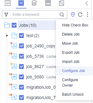

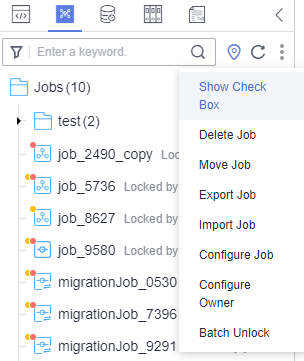

- Click
in the job directory and select Show Check Box.
Figure 1 Clicking Show Check Box - Select target jobs, click
, and select Configure Job.

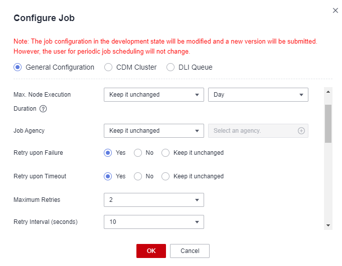

Figure 2 Configure Job - In the Configure Job dialog box, configure retry upon failures.
- Retry upon Failure: Select Yes to enable retry upon a failure for all nodes of the selected jobs.
- Retry upon Timeout: Set this parameter as needed. If a timeout interval is configured for a job node, the node can be retried upon an execution timeout.
- Maximum Retries: Set this parameter as needed. If the value is too large, execution time for downstream jobs may be shortened.
- Retry Interval (seconds): Set this parameter as needed. If the value is too large, execution time for downstream jobs may be shortened.
Figure 3 Configuring retry upon a failure - Click OK.

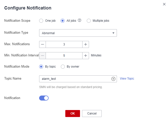

- On the Manage Notification page, click Configure Notification. In the displayed dialog box, set the following parameters:
- Notification Scope: You are advised to select All jobs. Notifications will be sent when existing and new jobs run improperly or fail.
- Notification Type: Select Abnormal. When a job is not running properly or fails, a notification is sent to notify the user of the abnormality.
You can also set Max. Notifications and Min. Notification Interval after a job becomes abnormal or fails and before the job is restored.
You can set Max. Notifications to a value from 1 to 50. If the default value 1 is used, Min. Notification Interval is not displayed.
You can set Min. Notification Interval to a value from 5 to 60.
- Notification Mode: You are advised to select By topic.
- Notification management depends on SMN, which may incur fees. For pricing details, contact the SMN support.
- Multiple message topics can be configured for a job. When the job is successfully executed or fails to be executed, notifications can be sent to multiple subscribers.
- Topic Name: Select an SMN message topic. If no proper topic is available, click View Topic to go to the SMN console and create one.
Currently, topics can be subscribed to only by SMS, email, or HTTP.
- Notification: whether to enable notification. This option is enabled by default.
Figure 4 Configuring notifications - Click OK.

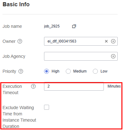

- On the job development page, click the Basic Info tab on the right of the canvas to set the following parameters:
- Execution Timeout: Set the timeout duration for the job instance. If you do not set this parameter or set it to 0, this parameter does not take effect. If you have configured notifications for the job by referring to Configuring Job Failure Alarms, and the execution of the job instance times out, the system sends a notification, and the job keeps running.
- Exclude Waiting Time from Instance Timeout Duration: Set whether to exclude the instance waiting time from the timeout duration of the instance.
Figure 5 Configuring the instance timeout duration
