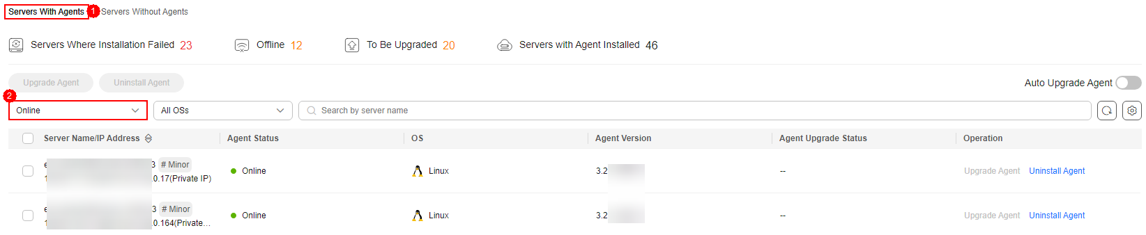

  4. Click the Servers with Agents tab and filter the servers with online agents.
    Figure 1 Filtering servers with online agents
  5. Click Uninstall Agent in the Operation column of a server. In the dialog box that is displayed, confirm the uninstallation information and click OK.
    If you need to uninstall the agent in batches, you can select servers and click Uninstall Agent above the list.
  6. Wait for about 5 to 10 minutes. Click the Servers Without Agents tab and find the target server. If the agent status of the target server is Uninstalled, the agent has been uninstalled.
