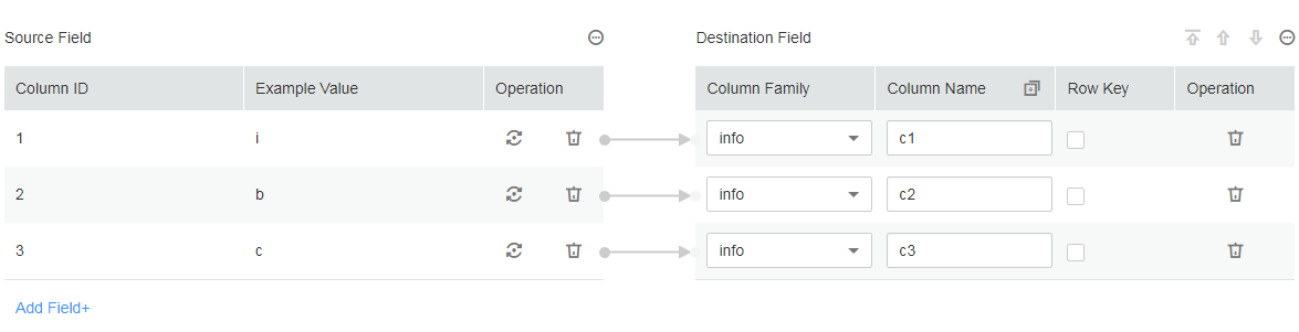

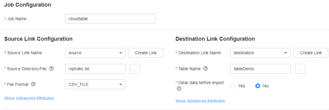

When you create a table/file migration job, if the table or file of the source end does not have the corresponding HBase table in the destination CloudTable cluster, set a table name and field mapping in the job for the destination end (the field name can be copied from the source end). Therefore, when a job is running, the corresponding HBase table is automatically created at the destination end.
The following uses the SFTP data source on an ECS as an example to describe how to create a job.
- On the Cluster Management page, locate the newly created CDM cluster and click Job Management in the row of the CDM cluster. The job management page is displayed.
- Choose Table/File Migration > Create Job.
- Configure basic information as follows. Figure 1 Configuring basic information
- Configure field mapping as follows. Figure 2 Field mapping
