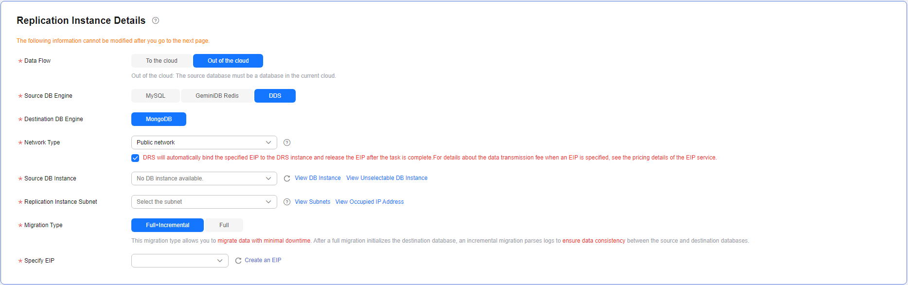

    Figure 2 Replication instance information
    Table 4 Replication instance settings
    Parameter
    Description
    Data Flow
    Select Out of the cloud.
    The source database is an RDS database on the current cloud or a DDS DB instance. It is required that either the source database or the destination database is on the current cloud.
    Source DB Engine
    Select DDS.
    Destination DB Engine
    Select MongoDB.
    Network Type
    Available options: Public network, VPC, VPN or Direct Connect
    • VPC is suitable for migrations of cloud databases.
    • VPN and Direct Connect are suitable for migrations from on-premises databases to cloud databases or between cloud databases across regions.
    • Public network is suitable for migrations from on-premises databases or external cloud databases to destination databases.
    Source DB Instance
    Select the DDS DB instance to be migrated.
    Replication Instance Subnet
    The subnet where the replication instance resides. You can also click View Subnet to go to the network console to view the subnet where the instance resides.
    By default, the DRS instance and the destination DB instance are in the same subnet. You need to select the subnet where the DRS instance resides, and there are available IP addresses for the subnet. To ensure that the replication instance is successfully created, only subnets with DHCP enabled are displayed.
    Migration Type
    • Full: This migration type is suitable for scenarios where service interruption is permitted. It migrates all objects and data in non-system databases to the destination database at one time. The objects include collections and indexes.
      NOTE:
      If you are performing a full migration, do not perform operations on the source database. Otherwise, data generated in the source database during the migration will not be synchronized to the destination database.
    • Full+Incremental: This migration type allows you to migrate data without interrupting services. After a full migration initializes the destination database, an incremental migration initiates and parses logs to ensure data consistency between the source and destination databases.
    NOTE:
    If you select Full+Incremental, data generated during the full migration will be continuously synchronized to the destination database, and the source remains accessible.
    Enterprise Project
    • If the DB instance has been associated with an enterprise project, select the target project from the Enterprise Project drop-down list.
    • You can also go to the ProjectMan console to create a project. For details about how to create a project, see the ProjectMan User Guide.
    Tags
    • This setting is optional. Adding tags helps you better identify and manage your tasks. Each task can have up to 10 tags.
    • After a task is created, you can view its tag details on the Tags tab. For details, see Tag Management.

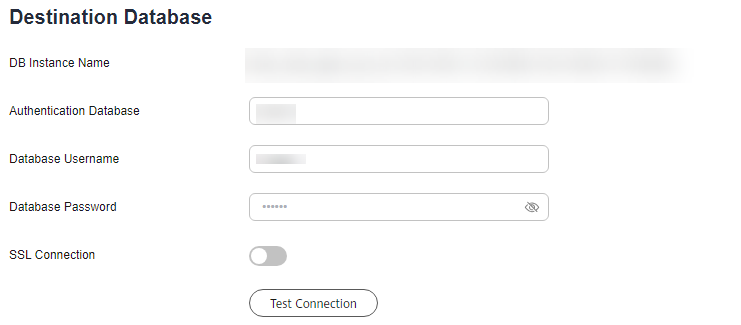

    Figure 3 Source database information
    Table 5 Source database settings
    Parameter
    Description
    DB Instance Name
    The DB instance you selected when creating the migration task. This parameter cannot be changed.
    Database Username
    Enter the username of the source database.
    Database Password
    Enter the password of the source database user.
    NOTE:
    The username and password of the source database are encrypted and stored in the database and the replication instance during the migration. After the task is deleted, the username and password are permanently deleted.

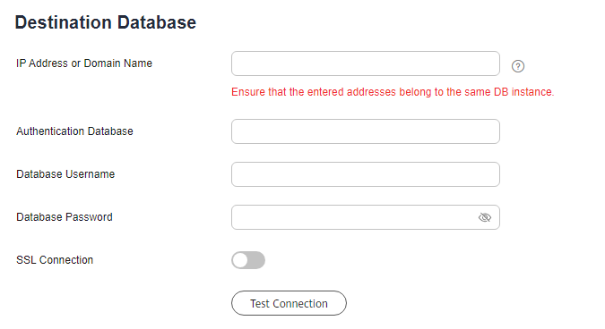

    Figure 4 Destination database information
    Table 6 Destination database settings
    Parameter
    Description
    IP Address or Domain Name
    IP address or domain name of the source database in the IP address/Domain name:Port format. The port of the source database. Range: 1 - 65534
    You can enter a maximum of three groups of IP addresses or domain names of the source database. Separate multiple values with commas (,). For example: 192.168.0.1:8080,192.168.0.2:8080. Ensure that the entered IP addresses or domain names belong to the same instance.
    NOTE:
    If multiple IP addresses or domain names are entered, the test connection is successful as long as one IP address or domain name is accessible. Therefore, you must ensure that the IP address or domain name is correct.
    Authentication Database
    The name of the authentication database. For example: The default authentication database of HUAWEI CLOUD DDS instance is admin.
    Database Username
    The username for accessing the destination database.
    Database Password
    The password for the database username.
    SSL Connection
    SSL encrypts the connections between the source and destination databases. If SSL is enabled, upload the SSL CA root certificate.
    NOTE:
    • The maximum size of a single certificate file that can be uploaded is 500 KB.
    • If the SSL certificate is not used, your data may be at risk.
    NOTE:
    The IP address, domain name, username, and password of the destination database are encrypted and stored in DRS and will be cleared after the task is deleted.

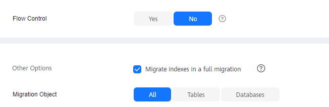

    Figure 5 Migration object
    Table 7 Migrate Object
    Parameter
    Description
    Other Options
    Determine whether to migrate the indexes you create during full migration. The default index based on _id is automatically created in the destination. If indexes are not migrated, the indexes are not compared.
    Migrate Object
    You can choose to migrate all objects, tables, or databases based on your service requirements.
    • All: All objects in the source database are migrated to the destination database. After the migration, the object names will remain the same as those in the source database and cannot be modified.
    • Tables: The selected table-level objects will be migrated.
    • Databases: The selected database-level objects will be migrated.
    If the source database is changed, click in the upper right corner before selecting migration objects to ensure that the objects to be selected are from the changed source database.
    NOTE:
    • When you select an object, the spaces before and after the object name are not displayed. If there are two or more consecutive spaces in the middle of the object name, only one space is displayed.
    • The search function can help you quickly select the required database objects.
