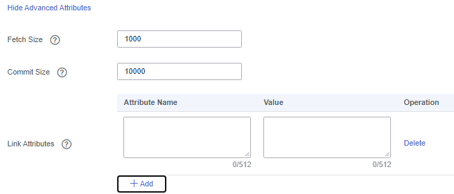

In the advanced attributes of the MySQL link, add either of the following parameters so that tables can be properly created at the destination:
- Parameter tinyInt1isBit, with its value set to false
- Parameter mysql.bool.type.transform, with its value set to false Figure 1 Adding link attributes
