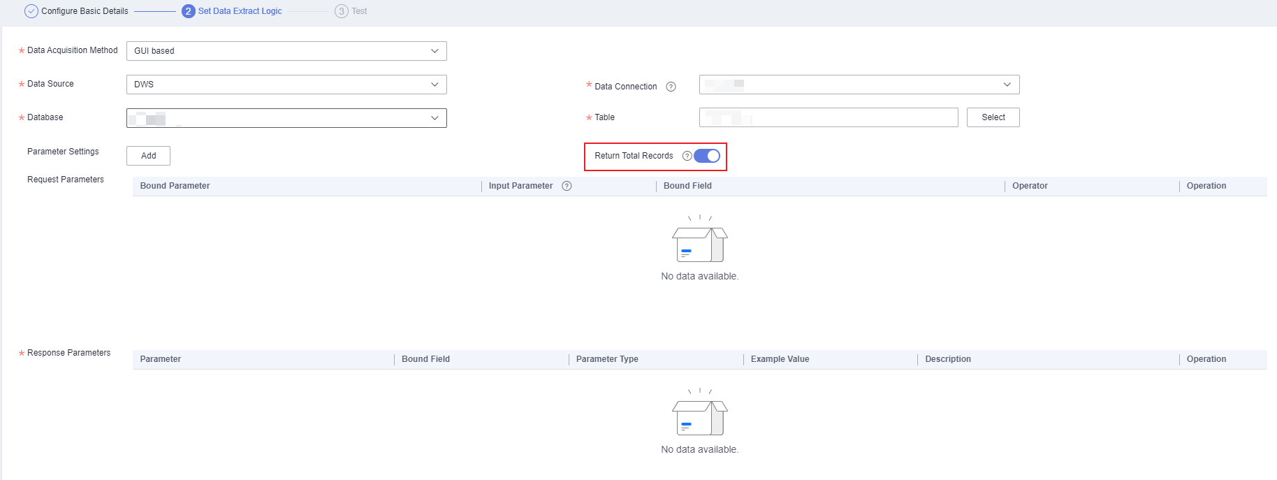

During API creation, Return Total Records is enabled. If a table contains a large amount of data, obtaining the total number of data records of the table through an API is time-consuming.
Figure 1 Return Total Records
