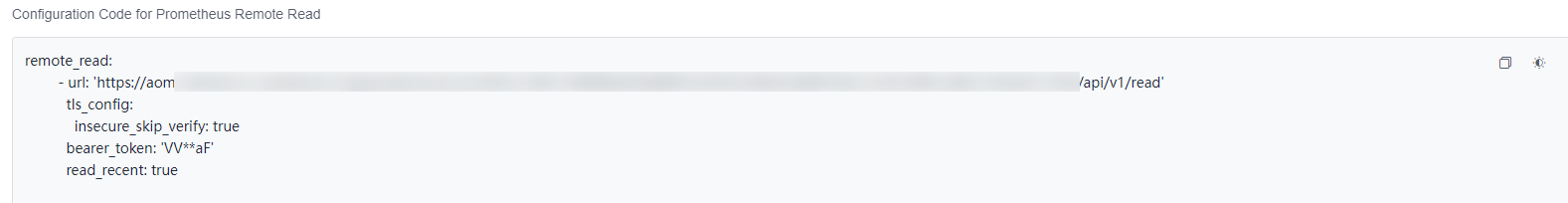

- Click the Intranet tab to obtain the configuration code for Prometheus remote read and write in the intranet. Click
on the right of the code to copy the code to the corresponding file. - Obtain the configuration code for Prometheus remote read. Figure 1 Configuration code for Prometheus remote read
Remote read address:
url: 'https://aom.{region_name}.{Site domain name suffix}/v1/{project_id}/api/v1/read'Remote read address parameters:- region_name: domain name or IP address of the server where the REST service is deployed. The value varies depending on services and regions.
- Site domain name suffix: site domain name suffix, for example, myhuaweicloud.com.
- project_id: project ID.

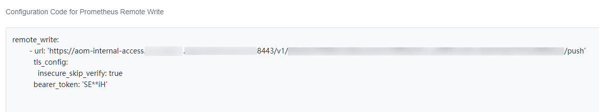

- Obtain the configuration code for Prometheus remote write. Figure 2 Configuration code for Prometheus remote write
Remote write address in the intranet:
url: 'https://aom-internal-access.{region_name}.{Site domain name suffix}:8443/v1/{project_id}/push'Remote write address parameters:- region_name: domain name or IP address of the server where the REST service is deployed. The value varies depending on services and regions.
