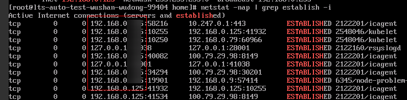

  2. Check the host IP address in use, as shown in Figure 1:
    netstat -nap | grep establish -i
    Figure 1 Checking the host IP address

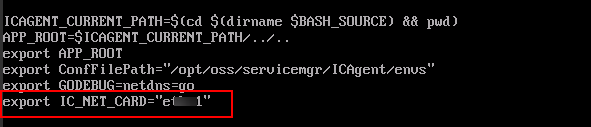

  5. Modify the ICAgent startup script:
    1. Open the icagent_mgr.sh file (command varies depending on the ICAgent version):
      vi /opt/oss/servicemgr/ICAgent/bin/manual/icagent_mgr.sh
      Or
      vi /var/opt/oss/servicemgr/ICAgent/bin/manual/icagent_mgr.sh
    2. Modify the script file:
      Add export IC_NET_CARD=NIC name to the file, as shown in Figure 3.
      Figure 3 Modifying the script
