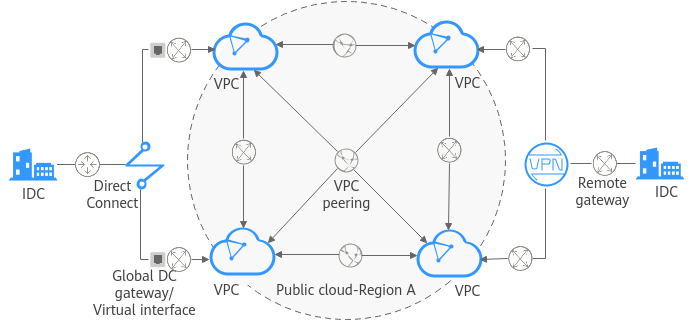

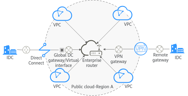

Figure 1 and Figure 2 show the networks with and without enterprise routers, respectively. Table 1 compares the two networks.
Figure 1 A network without enterprise routers
Figure 2 A network with enterprise routers

Communications among VPCs in the same region
  • Create six VPC peering connections between these four VPCs in the same region.
  • Add 12 routes, with three routes for each VPC to communicate with the other three VPCs.
  • Attach the four VPCs to one enterprise router. This router can then handle the traffic from and to all the connected VPCs.
  • Add routes to the route tables of these four VPCs for routing traffic through the enterprise router. The enterprise router can automatically learn the VPC CIDR blocks and add them to its route table.
  • There is no need to configure a large number of VPC peering connections.
  • Fewer routes need to be added, simplifying the maintenance.
Communications between an on-premises data center and VPCs
Establish Direct Connect or VPN connections between each VPC and the data center.
Attach the Direct Connect or VPN connection to the enterprise router. These VPCs can then share the connection.
  • Route propagation simplifies the route configuration and the O&M.
  • Multiple lines work in load-sharing or active/standby mode to achieve higher availability.
The comparison shows that the network with enterprise routers is simpler and highly scalable and is also easier to maintain.
