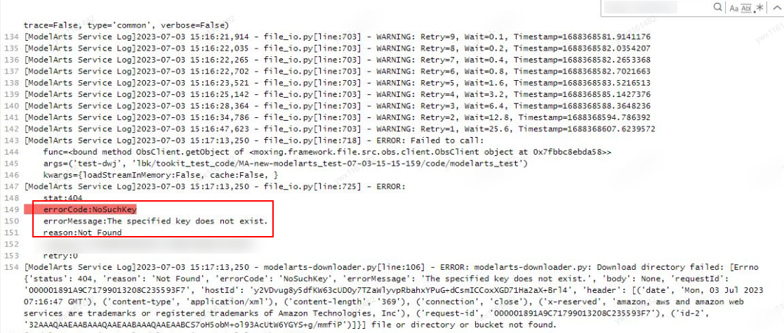

When PyCharm Toolkit is used to submit a training job, an error is reported. The log is as follows.
Possible Causes
The image version is too old and incompatible with the training job.

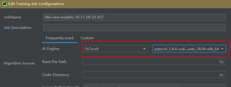

Solution
When using PyCharm Toolkit to submit a training job, select a frequently-used engine version supported by the training job. For details about the supported versions, see AI engines supported by training jobs. Do not select PyTorch-1.0.0, PyTorch-1.3.0, or PyTorch-1.4.0.
Figure 1 Selecting an AI engine supported by the training job
