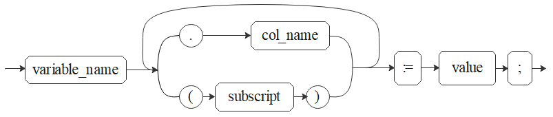

Nested Value Assignment
Figure 2 shows the syntax diagram for assigning a nested value to a variable.
The syntax in Figure 2 is described as follows:
- variable_name: specifies the name of a variable.
- col_name: specifies the column name.
- subscript: index, which is used for an array variable. The value can be a value or an expression and must be of the INT type.
- value: can be a value or an expression. The type of value must be compatible with the type of variable_name.
