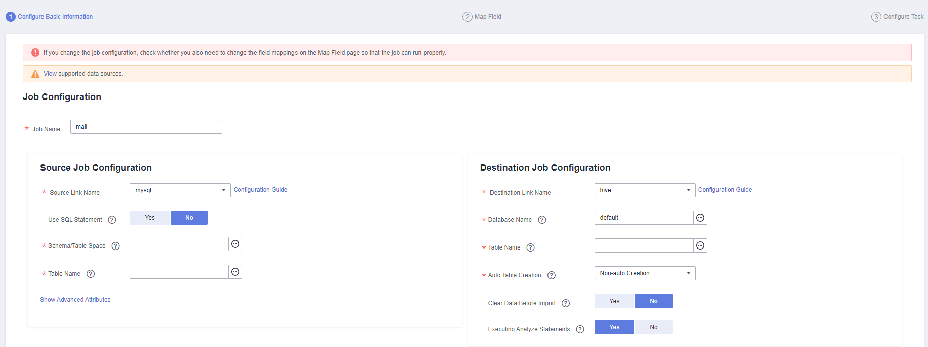

  1. Create a job for migrating the first MySQL table mail001 to the MRS Hive table mail.
    Note: Select Do not Delete for the Delete Job After Completion parameter.

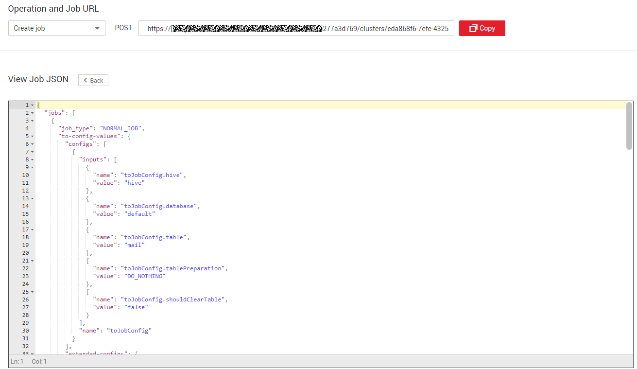

  2. After the sample job is created, view and copy the job JSON for subsequent configuration of data development jobs.

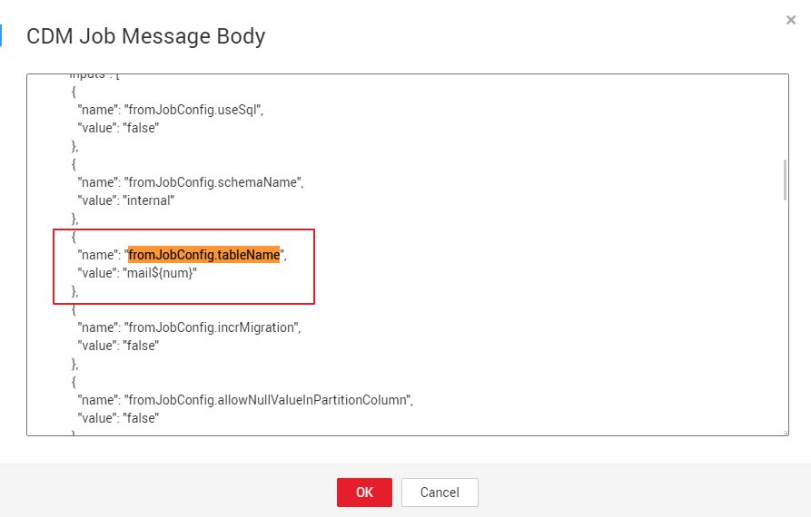

    1. Since there are three source tables mail001, mail002, and mail003, you need to set fromJobConfig.tableName to mail${num} in the JSON file of the job. The following figure shows the parameters for creating a main job.

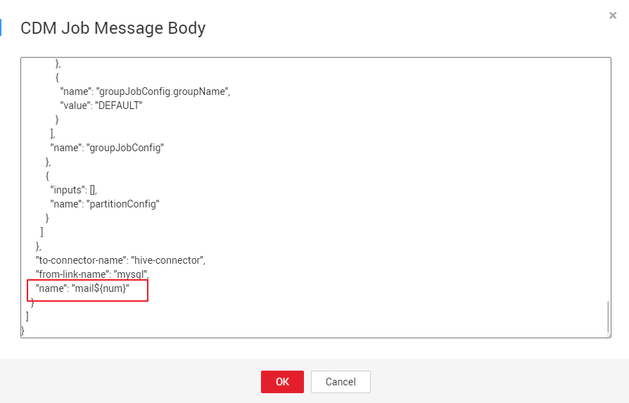

    2. The name of each data migration job must be unique. Therefore, you need to change the value of name in the JSON file to mail${num} to create multiple CDM jobs. The following figure shows the parameters for creating a main job.

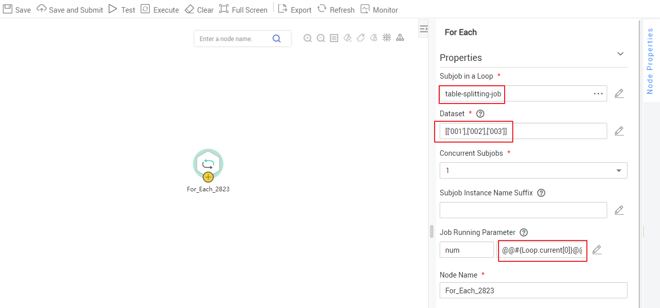

  5. Create the main job integration_management. Select the For Each node that executes the subjobs in a loop and transfers parameters 001, 002, and 003 to the subjobs to generate different table extraction tasks.
    The key configurations are as follows:
    • Subjob in a Loop: Select table.
    • Dataset: Enter [['001'],['002'],['003']].
    • Job Running Parameter: Enter @@#{Loop.current[0]}@@.
      NOTE:
      Add @@ to the EL expression of the job running parameter. If @@ is not added, dataset 001 will be identified as 1. As a result, the source table name does not exist.
