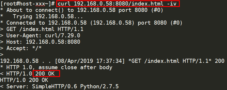

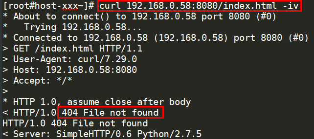

  • For HTTP health checks, run the following command on the backend server to check the status code:
    curl Private IP address of the backend server:Health check port/Health check path -iv
    To perform an HTTP health check, the load balancer sends a GET request to the backend server. If the following response status codes are displayed, the backend server is considered healthy:
    TCP listeners: 200
    200, 202, or 401 for HTTP health checks
    Figure 3 Unhealthy backend server
    Figure 4 Healthy backend server
