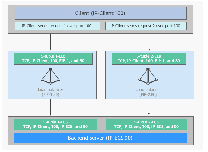

Figure 1 shows how two load balancers (with Transfer Client IP Address enabled) forward client requests to the same backend server over the same source port.
- The client (IP-Client) uses the same source port (port 100) to send TCP request 1 to EIP1 (12.xx.xx.xx) and TCP request 2 to EIP2 (13.xx.xx.xx) bound to two load balancers.
- The two TCP listeners forward client requests over the same port (port 80), and the two load balancers receive the 5-tuples as follows:

- Each load balancer forwards the client requests to the same backend server (IP-ECS) over port 90.
- Transfer Client IP Address has been enabled for the two TCP listeners, so the source IP address and source port are not changed. In this case, IP-ECS receives the 5-tuples from load balancers as follows:

- IP-ECS receives requests 1 and 2 with the same 5-tuple, causing connection failures.
