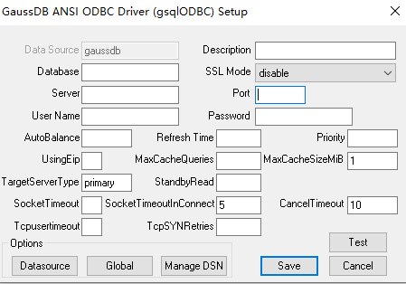

  3. Configure a data source.
    On the User DSN tab, click Add and choose GaussDB Unicode for setup.
    For details about the parameters, see Configuring a Data Source in the Linux OS.

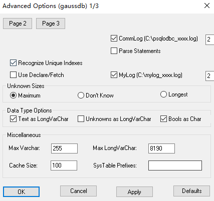

    You can click Datasource to configure whether to print logs.

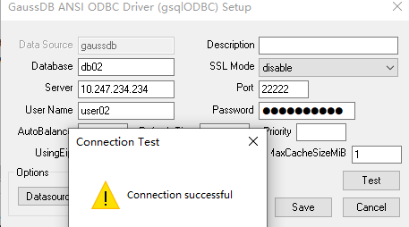

  5. Test the connection.
    Click Test.
    • If the following information is displayed, the configuration is correct and the connection succeeds.
    • If error information is displayed, the configuration is incorrect. Check whether the preceding configurations are correct.
