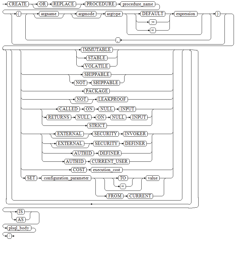

Syntax
1 2 3 4 5 6 7 8 9 10 11 12 13 14 15 | CREATE [ OR REPLACE ] PROCEDURE procedure_name [ ( {[ argname ] [ argmode ] argtype [ { DEFAULT | := | = } expression ]}[,...]) ] [ { IMMUTABLE | STABLE | VOLATILE } | { SHIPPABLE | NOT SHIPPABLE } | {PACKAGE} | [ NOT ] LEAKPROOF | { CALLED ON NULL INPUT | RETURNS NULL ON NULL INPUT | STRICT } | {[ EXTERNAL ] SECURITY INVOKER | [ EXTERNAL ] SECURITY DEFINER | AUTHID DEFINER | AUTHID CURRENT_USER} | COST execution_cost | SET configuration_parameter { [ TO | = ] value | FROM CURRENT } ][ ... ] { IS | AS } plsql_body / |
Parameters
- OR REPLACE
Replaces the original definition when two stored procedures are with the same name.
- procedure_name
Specifies the name of the stored procedure that is created (optionally with schema names).
Value range: a string that complies with the Identifier Naming Conventions.
You are advised not to create a function with the same name as a system function. Otherwise, you need to specify the schema of the function when calling the function.
- argmode
Specifies the mode of an argument.
VARIADIC specifies parameters of the array type.
Value range: IN, OUT, INOUT, and VARIADIC. The default value is IN. Only the parameter of the OUT mode can be followed by VARIADIC. The parameters of OUT and INOUT cannot be used in procedure definition of RETURNS TABLE.
- argname
Specifies the argument name.
- argtype
Specifies the type of an argument. You can use %ROWTYPE to indirectly reference the type of a table, or %TYPE to indirectly reference the type of a column in a table or composite type.
Value range: a valid data type
No specific order is applied to argname and argname. The following order is advised: argname, argmode, and argtype.
- expression
Specifies the default expression of a parameter.
- If a_format_version is set to 10c and a_format_dev_version is set to s2, the default expression is not supported when the parameter is in INOUT mode.
- It is recommended that you define all default parameters after all non-default parameters.
- If a function with default parameters is called, input parameters are added to the function from left to right. If inputs of non-default parameters are missing, an error is reported.
- If proc_uncheck_default_param is enabled and a function with default parameters is called, input parameters are added to the function from left to right. These inputs can be set to default values. If an input of a non-default parameter is missing, the previous default value is used to fill this parameter.
- When a_format_version is set to 10c, a_format_dev_version is set to s1, proc_outparam_override is disabled, and the function parameters include the output parameter out and default, the default value cannot be used.
- IMMUTABLE, STABLE,...
Specifies a constraint. The function of each parameter is similar to that of CREATE FUNCTION. For details, see CREATE FUNCTION.
- plsql_body
Specifies the PL/SQL stored procedure body.
When a stored procedure is created, the PLSQL_BODY can end with "END;" or "END procedure_name;".
Constraints for storage procedures ending with "END procedure_name;":
- It is supported only in ORA-compatible mode (database level).
- Only the ORA-style creation syntax is supported.
- Only the scenario where the stored procedure name is set after END is supported.
- In the DBE_PLDEVELOPER.gs_source, my_source, db_source and adm_source views, the definition of the stored procedure stays consistent (if the created procedure is "END+name", it is displayed as "END+name"). In the pg_proc and \sf views, the outermost END is not followed by a name in any case. The innermost END is displayed as defined during creation (if the created procedure is "END+name", it is displayed as "END+name").
- The stored procedure cannot retain the name following the outermost END in the SQL file generated by gs_dump.
- If a stored procedure is named IF/LOOP or a subprogram is nested, the stored procedure cannot be ended with END IF/LOOP.
When you perform password-related operations, such as user creation, password change, and encryption/decryption, in a stored procedure, the password will be recorded in the system catalogs and logs in plaintext. To prevent sensitive information leakage, you are advised not to perform password-related operations in a stored procedure.
