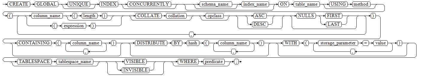

Syntax
CREATE GLOBAL [ UNIQUE ] INDEX [ CONCURRENTLY ] [ [schema_name.]index_name ] ON table_name [ USING method ]
({ { column_name [ ( length ) ] | ( expression ) } [ COLLATE collation ] [ opclass ] [ ASC | DESC ] [ NULLS { FIRST | LAST } ] }[, ...] )
[CONTAINING (column_name [ ,... ])] [DISTRIBUTE BY hash(column_name [ ,... ])][ WITH ( {storage_parameter = value} [, ... ] )]
[ TABLESPACE tablespace_name ] [ VISIBLE | INVISIBLE ] [ WHERE predicate];
