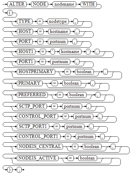

Syntax
1 2 3 4 5 6 7 8 9 10 11 12 13 14 15 16 17 | ALTER NODE nodename WITH ( [ TYPE = nodetype,] [ HOST = hostname,] [ PORT = portnum,] [ HOST1 = 'hostname',] [ PORT1 = portnum,] [ HOSTPRIMARY [ = boolean ],] [ PRIMARY [ = boolean ],] [ PREFERRED [ = boolean ],] [ SCTP_PORT = portnum,] [ CONTROL_PORT = portnum,] [ SCTP_PORT1 = portnum,] [ CONTROL_PORT1 = portnum, ] [ NODEIS_CENTRAL [ = boolean ],] [ NODEIS_ACTIVE [= boolean] ] ); |
