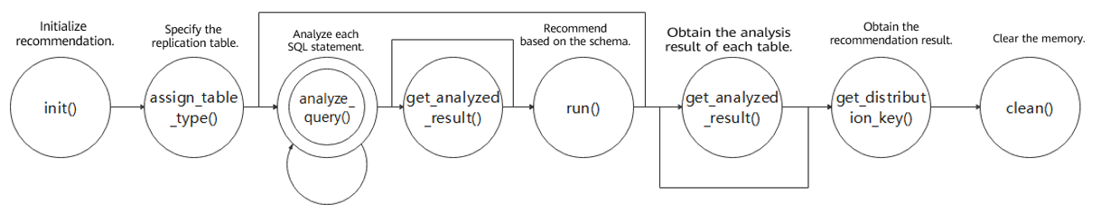

sqladvisor.analyze_query(text, int)
Description: Imports SQL statements to be recommended and analyzes the components of the statements.
Return type: Boolean

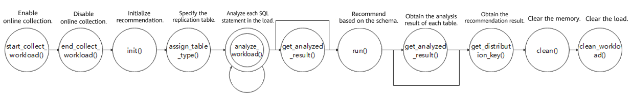

sqladvisor.analyze_workload()
Description: Analyzes the load information collected online.
sqladvisor.get_analyzed_result(text)
Description: Obtains beneficial components extracted from the current table.
Parameter: text
Return type: record

sqladvisor.run()
Description: Performs calculation and analysis based on the specified schema and input SQL statements.
sqladvisor.get_distribution_key()
Description: Obtains the recommendation result.
The analysis result is saved in a session. If the session disconnects, the result will be lost.
Return type: record

sqladvisor.clean()
Description: Clears all the memory in the recommendation process of a session.
sqladvisor.start_collect_workload(int, int)
Description: Starts online load collection.

sqladvisor.end_collect_workload()
Description: Disables online load collection.

sqladvisor.clean_workload()
Description: Clears the memory in the load.
