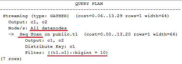

In some scenarios, implicit data type conversion may cause performance problems. See the following scenario:
SET enable_fast_query_shipping = off;
CREATE TABLE t1(c1 VARCHAR, c2 VARCHAR);
CREATE INDEX on t1(c1);
EXPLAIN verbose SELECT * FROM t1 WHERE c1 = 10;
The execution plan of the preceding query is as follows.
The data type of c1 is varchar. When the filter criterion is c1 = 10, the optimizer implicitly converts the data type of c1 to bigint by default. As a result, the following two consequences occur:
  • DN tailoring is not allowed. The plan is delivered to all DNs for execution.
  • The Index Scan mode cannot be used to scan data in the plan.
These may cause performance problems.
After knowing the causes, you can rewrite the SQL statements. In the preceding scenario, you only need to convert the constant display in the filter criteria to the varchar type. The result is as follows:
EXPLAIN verbose SELECT * FROM t1 WHERE c1 = 10::varchar;
