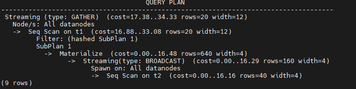

After no_expand is added:
1 | explain select * from t1 where t1.c1 in (select /*+ no_expand*/ t2.c1 from t2); |
Plan
