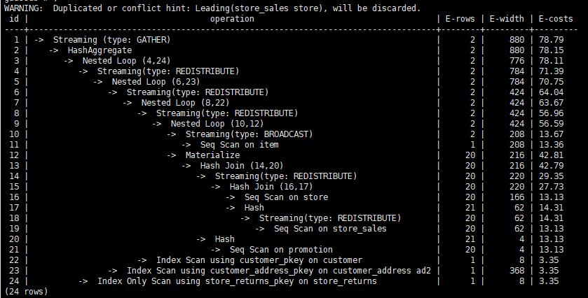

1 2 | explain select /*+ leading((((((store_sales store) promotion) item) customer) ad2) store_returns) leading((store store_sales))*/ i_product_name product_name ... |
First, store_sales and store are joined and store_sales is the inner table. Then, the result is joined with promotion, item, customer, ad2, and store_returns in sequence. The optimized plan is as follows.
For details about the warning at the top of the plan, see Hint Errors, Conflicts, and Other Warnings.
