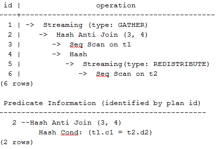

  • Convert NOT IN to NOT EXISTS.
    Nested loop anti join must be used to implement NOT IN, and hash anti join is required for NOT EXISTS. If no NULL value exists in the join columns, NOT IN is equivalent to NOT EXISTS. Therefore, if you are sure that no NULL value exists, you can convert NOT IN to NOT EXISTS to generate hash join and to improve the query performance.
    As shown in the following statement, if the t2.d2 column does not contain NULL values (it is set to NOT NULL), the query can be modified as follows:
    SELECT * FROM t1 WHERE  NOT EXISTS (SELECT * FROM t2 WHERE t1.c1=t2.d2);
    The generated execution plan is as follows:
    Figure 1 NOT EXISTS execution plan
