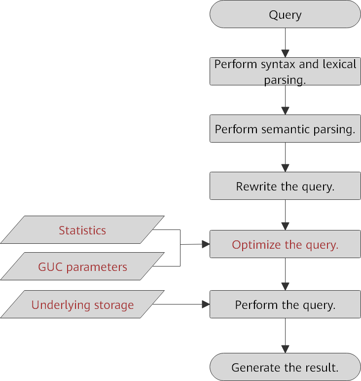

Query Execution Process
The process from receiving SQL statements to the statement execution by the SQL engine is shown in Figure 1 and described in Table 1. The texts in red are steps where database administrators can optimize queries.
| Step | Description |
| 1. Perform syntax and lexical parsing. | Converts the input SQL statements from the string data type to the formatted structure stmt based on the specified SQL statement rules. |
| 2. Perform semantic parsing. | Converts the formatted structure obtained from the previous step into objects that can be recognized by the database. |
| 3. Rewrite the query statements. | Converts the output of the previous step into the structure that optimizes the query execution. |
| 4. Optimize the query. | Determines the execution mode of SQL statements (the execution plan) based on the result obtained from the previous step and the internal database statistics. For details about how the internal database statistics and GUC parameters affect the query optimization (execution plan), see Optimizing Queries Using Statistics and Optimizing Queries Using GUC parameters. |
| 5. Perform the query. | Executes the SQL statements based on the execution path specified in the previous step. Selecting a proper underlying storage mode improves the query execution efficiency. |
