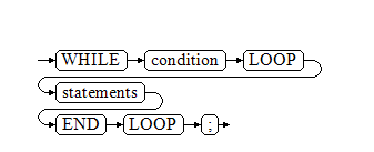

WHILE_LOOP Statements
Syntax diagram
If the conditional expression is true, a series of statements in the WHILE statement are repeatedly executed and the condition is decided each time the loop body is executed.
Example
1 2 3 4 5 6 7 8 9 10 11 12 13 14 15 16 17 18 19 20 21 22 23 24 25 26 27 28 | gaussdb=# CREATE TABLE integertable(c1 integer) DISTRIBUTE BY hash(c1); CREATE TABLE gaussdb=# CREATE OR REPLACE PROCEDURE proc_while_loop(maxval in integer) AS DECLARE i int :=1; BEGIN WHILE i < maxval LOOP INSERT INTO integertable VALUES(i); i:=i+1; END LOOP; END; / CREATE PROCEDURE -- Call the stored procedure. gaussdb=# CALL proc_while_loop(10); proc_while_loop ----------------- (1 row) -- Drop the stored procedure and table. gaussdb=# DROP PROCEDURE proc_while_loop; DROP PROCEDURE gaussdb=# DROP TABLE integertable; DROP TABLE |

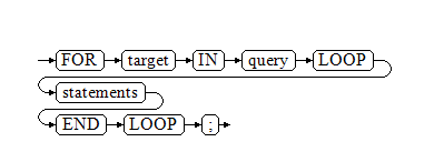

FOR_LOOP Query Statements
Syntax diagram
- The variable target is automatically defined, its type is the same as that in the query result, and it is valid only in this loop. The target value is the query result.
- You can use EXECUTE to add a dynamic query and use USING to insert parameters to the query. For details, see the dynamic query content in Example.
1 2 3 4 5 6 7 8 9 10 11 12 13 14 15 16 17 18 19 20 21 22 23 24 | -- Display the query result from the loop. gaussdb=# CREATE OR REPLACE PROCEDURE proc_for_loop_query() AS record VARCHAR2(50); BEGIN FOR record IN SELECT spcname FROM pg_tablespace LOOP dbe_output.print_line(record); END LOOP; END; / CREATE PROCEDURE -- Call the stored procedure. gaussdb=# CALL proc_for_loop_query(); pg_default pg_global proc_for_loop_query --------------------- (1 row) -- Drop the stored procedure. gaussdb=# DROP PROCEDURE proc_for_loop_query; DROP PROCEDURE |
