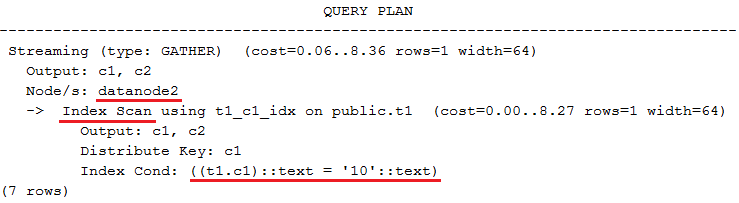

After knowing the causes, you can rewrite the SQL statements. In the preceding scenario, you only need to convert the constant display in the filter criteria to the varchar type. The result is as follows:
EXPLAIN verbose SELECT * FROM t1 WHERE c1 = 10::varchar;
