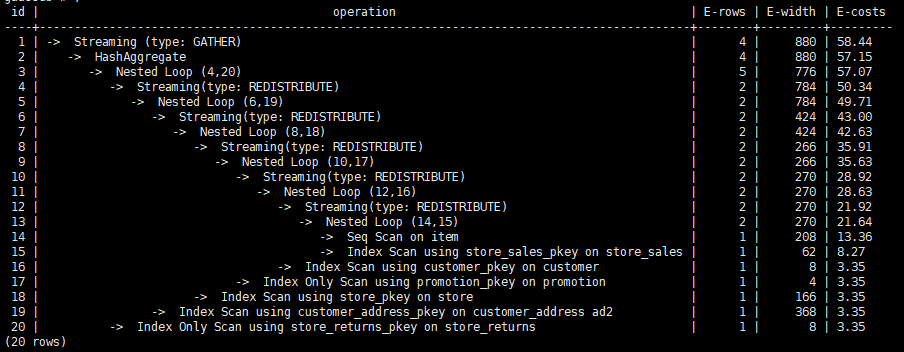

Hint the query plan in Examples as follows:
1 2 | explain select /*+ rows(store_sales store_returns *50) */ i_product_name product_name ... |
Multiply the result set of joined store_sales and store_returns by 50. The optimized plan is as follows.
The estimation value after the hint in row 11 is 360, and the original value is rounded off to 7.
