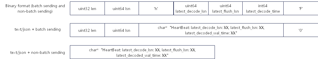

- Heartbeat log output option
enable-heartbeat: specifies whether to generate heartbeat logs. The default value is false.
The following information is about parsing heartbeat logs with figure showing the format of the logs (in consideration of forward compatibility, the LSN naming mode is retained. The actual meaning depends on the actual scenario):
- In the binary format, the message starts with the character 'h', indicating a heartbeat log.
- The following is the heartbeat log content. For the first 8-byte uint64 string, in the decoding scenario where DNs are directly connected, this string is an LSN, indicating the end position of the WAL read when the heartbeat logical log is sent; in the decoding scenario where distributed strong consistency is required, this string is a CSN, indicating the decoding log transaction CSN that has been sent when the heartbeat logical log is sent. For the second 8-byte uint64 string, in the decoding scenario where DNs are directly connected, this string is an LSN, indicating the location of the WAL that has been flushed to disks when the heartbeat logical log is sent; in the decoding scenario where distributed strong consistency is required, this string is a CSN, indicating the CSN to be obtained by the next transaction committed by the cluster. The last 8-byte int64 string indicates the generation timestamp (starting from January 1, 1970) of the latest decoded transaction log or checkpoint log.
- Message terminator: If in binary format, it is 'F'. If the format is TEXT or JSON and the message is sent in batches, the terminator is '0'. Otherwise, there is no terminator. The message content is transmitted in big-endian mode.
