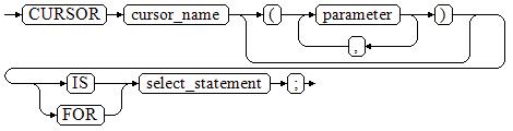

- Define a static cursor: Define a cursor name and its corresponding SELECT statement.
Figure 1 shows the syntax diagram for defining a static cursor.
Parameter description:
- cursor_name: defines a cursor name.
- parameter: specifies cursor parameters. Only input parameters are allowed. Its format is as follows:
parameter_name datatype
- select_statement: specifies a query statement.
- The system automatically determines whether the cursor can be used for backward fetching based on the execution plan.
- In syntax, parameter can be an output parameter, but its behavior is the same as that of an input parameter.
