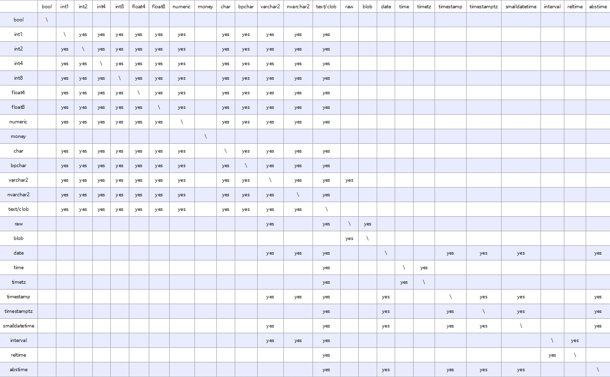

The following figure shows the supported implicit type conversion when set sql_beta_feature is set to 'a_style_coerce' in ORA-compatible mode. \ indicates that conversion is not required, yes indicates that conversion is supported, and the blank value indicates that conversion is not supported.

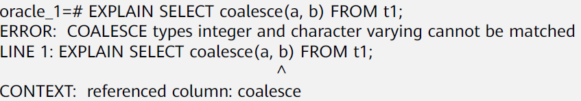

Example 4: In the TD type, if input parameters for COALESCE are of int and varchar types, resolve as type varchar. In ORA-compatible mode, an error is reported.
-- In Oracle-compatible mode, create the ORA-compatible database oracle_1. openGauss=# CREATE DATABASE oracle_1 dbcompatibility = 'ORA'; -- Switch to the oracle_1 database. openGauss=# \c oracle_1 -- Create the t1 table. oracle_1=# CREATE TABLE t1(a int, b varchar(10));
-- Delete the table. oracle_1=# DROP TABLE t1; -- Switch to the testdb database. oracle_1=# \c testdb -- In TD mode, create the td_1 database compatible with Teradata. openGauss=# CREATE DATABASE td_1 dbcompatibility = 'TD'; -- Switch to the td_1 database. openGauss=# \c td_1 -- Create the t2 table. td_1=# CREATE TABLE t2(a int, b varchar(10)); -- Show the execution plan of a statement for querying the types int and varchar of input parameters for COALESCE. td_1=# EXPLAIN VERBOSE select coalesce(a, b) from t2; QUERY PLAN --------------------------------------------------------------------------------------- Data Node Scan (cost=0.00..0.00 rows=0 width=0) Output: (COALESCE((t2.a)::character varying, t2.b)) Node/s: All datanodes Remote query: SELECT COALESCE(a::character varying, b) AS "coalesce" FROM public.t2 (4 rows) -- Delete the table. td_1=# DROP TABLE t2; -- Switch to the testdb database. td_1=# \c testdb -- Delete databases in Oracle and TD mode. openGauss=# DROP DATABASE oracle_1; openGauss=# DROP DATABASE td_1;
