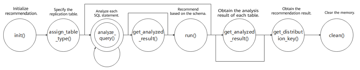

- sqladvisor.assign_table_type(text)
Description: Specifies a table as a replication table.
Parameter: table name
Return type: Boolean
The specified replication table must be used before analyze_query and analyze_workload are called.
- sqladvisor.analyze_query(text, int)
Description: Imports SQL statements to be recommended and analyzes the components of the statements.
| Parameter | Type | Description | Required (Yes/No) |
| query | text | SQL statement | Yes |
| frequency | int | Frequency of a statement in the load. The default value is 1. The value ranges from 1 to 2147483647. | No |
- If the value of the query parameter contains special characters, such as single quotation marks ('), you can use single quotation marks (') to escape the special characters.
- This function is not supported in semi-online mode.

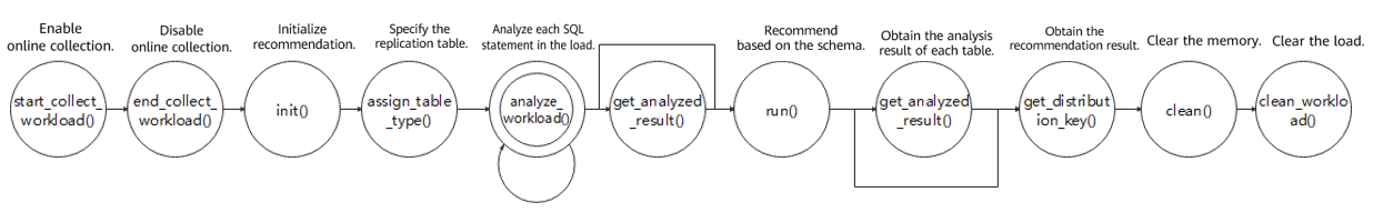

- sqladvisor.analyze_workload()
Description: Analyzes the load information collected online.
- sqladvisor.get_analyzed_result(text)
Description: Obtains beneficial components extracted from the current table.
Parameter: text
Return type: record
The following table describes return fields.
| Name | Type | Description |
| schema_name | text | Schema name |
| table_name | text | Table name |
| col_name | text | Column name |
| operator | text | Operator type |
| count | int | Number of times that an operator is used |
- sqladvisor.run()
Description: Performs calculation and analysis based on the specified schema and input SQL statements.
- sqladvisor.get_distribution_key()
Description: Obtains the recommendation result.
The analysis result is saved in a session. If the session disconnects, the result will be lost.
Return type: record
| db_name | text | Database name |
| distribution_type | text | Recommended distribution type |
| distribution_key | text | Recommended distribution key |
| start_time | timestamp | Recommended start time |
| end_time | timestamp | Recommended end time |
| cost_improve | text | Cost increase brought by the recommendation result |
| comment | text | Comment |
- sqladvisor.clean()
Description: Clears all the memory in the recommendation process of a session.
- sqladvisor.start_collect_workload(int, int)
Description: Starts online load collection.
| sqlCount | int | Maximum number of SQL statements for online load collection. The value ranges from 1 to 100000 and the default value is 10000. | Yes |
| maxMemory | int | Maximum memory occupied by online load collection. The default value is 1024. The value ranges from 1 to 10240, in MB. | Yes |
- The online collection function can be called only by a system administrator.
- The load of only one database can be collected at a time.
- Currently, only common SQL statements as well as DML and DQL statements in stored procedures are supported.
- sqladvisor.end_collect_workload()
Description: Disables online load collection.
- The online collection function can be disabled only by a system administrator.
- sqladvisor.clean_workload()
Description: Clears the memory in the load.
- The function of clearing memory in the load can be called only by a system administrator.
- You must manually execute the cleanup function.
