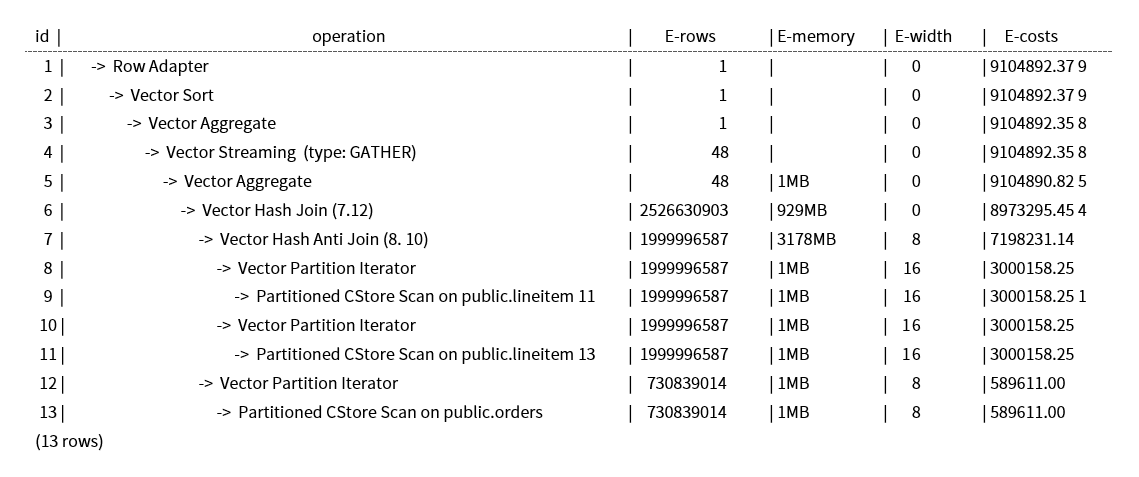

The following figure shows the execution plan. (When verbose is used, distinct is added for column selection which is controlled by cost off/on. The hash join rows show the estimated number of distinct values and the other rows do not.)
Optimization Analysis 1
These queries are from Anti Join connected in the lineitem table. When bit0 of cost_param is set to 1, the estimated number of Anti Join rows greatly differ from that of the actual number of rows so that the query performance deteriorates. You can estimate the number of Anti Join rows more accurately by setting bit0 of cost_param to 1 to improve the query performance. The optimized execution plan is as follows:

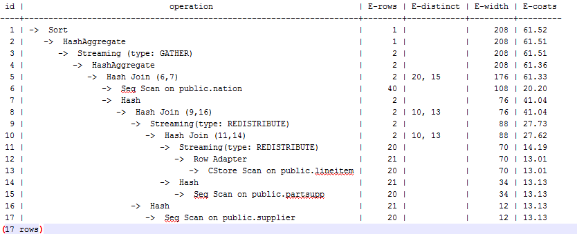

When bit1 of cost_param is set to 0, the execution plan is shown as follows:
Optimization Analysis 2

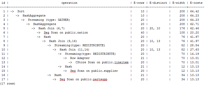

In the preceding queries, the hash join criteria of the supplier, lineitem, and partsupp tables are setting lineitem.l_suppkey to supplier.s_suppkey and lineitem.l_partkey to partsupp.ps_partkey. Two filter criteria exist in the hash join conditions. lineitem.l_suppkey in the first filter criterion and lineitem.l_partkey in the second filter criterion are two columns with strong relationship of the lineitem table. In this situation, when you estimate the rate of the hash join conditions, if bit1 of cost_param is set to 0, the selectivity is estimated based on multiple filter criteria. The lowest selectivity among all filter criteria, but not the product of the selectivities for two tables under a specific filter criterion, is used as the total selectivity. Therefore, you need to set bit1 of cost_param to 2 and select the lowest selectivity as the total selectivity to optimize the query performance. The optimized query plan is shown in the following figure.
