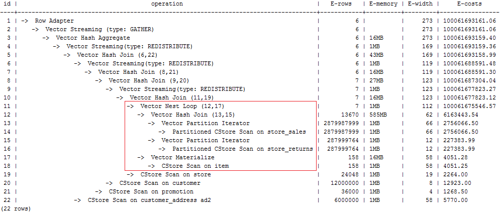

Hint the query plan in Example as follows:
1 2 | explain select /*+ nestloop(store_sales store_returns item) */ i_product_name product_name ... |
nestloop is used for the last join between store_sales, store_returns, and item. The optimized plan is as follows:
