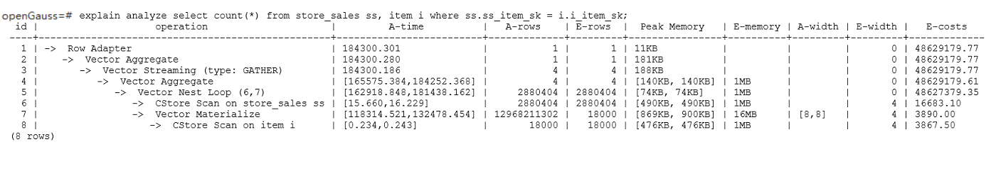

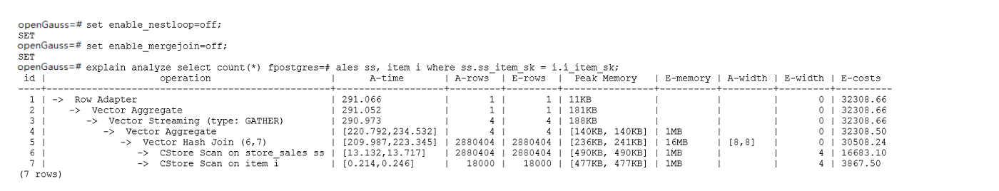

2: If NestLoop is used for joining tables with a large number of rows, the join may take a long time. In the following example, NestLoop takes 181s. If enable_mergejoin is set to off to disable merge join and enable_nestloop is set to off to disable NestLoop so that the optimizer selects hash join, the join takes more than 200 ms.

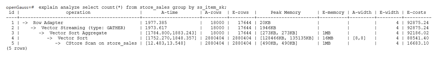

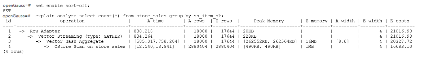

3. Generally, query performance can be improved by selecting HashAgg. If Sort and GroupAgg are used for a large result set, you need to set enable_sort to off. HashAgg consumes less time than Sort and GroupAgg.
