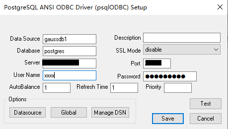

- Configure a data source.
On the User DSN tab, click Add and choose PostgreSQL Unicode for setup.
The entered username and password will be recorded in the Windows registry and you do not need to enter them again when connecting to the database next time. For security purposes, you are advised to delete sensitive information before clicking Save and enter the required username and password again when using ODBC APIs to connect to the database.
- Enable the SSL mode.
Change the value of SSL Mode in 3 to require.

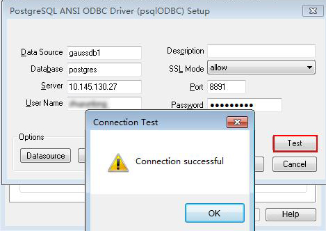

Verifying the Data Source Configuration
Click Test.
- If the following information is displayed, the configuration is correct and the connection succeeds.
- If error information is displayed, the configuration is incorrect. Check the configuration.
