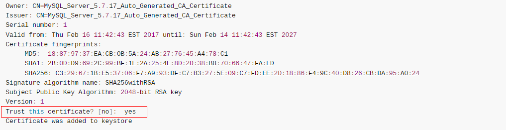

  1. Run the following command on the ECS where the MySQL client has been installed to import the server certificate:
    • your_certificate_path: path for storing the custom certificate
    • your_truststore_name: user-defined truststore name
    • your_truststore_password: user-defined truststore password
    keytool -importcert -alias MySQLCACert -file your_certificate_path -keystore your_truststore_name -storepass your_truststore_password
  2. Enter yes when prompted, as shown in the following figure.
    Figure 1 Running the command
