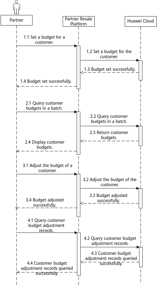

API Invoking Process
Development Suggestions
- Customers' budgets are used to control the customers' total expenditures of each month. Partners need to configure proper budgets for the customers based on actual requirements.
- If the partner sales platform detects that a customer's budget is less than or equal to 0, the customer is forbidden to purchase or renew resources.
- The API for configuring customer's budgets is invoked when a partner sets the budget for a customer for the first time or adjusts the budget.
