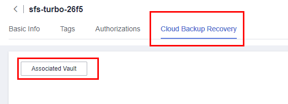

- In the SFS Turbo file system list, locate the file system you want to back up and click the name to go to its details page.
- Click the Backups tab.
Figure 1 Associated Vault
- Click Associate with Vault.

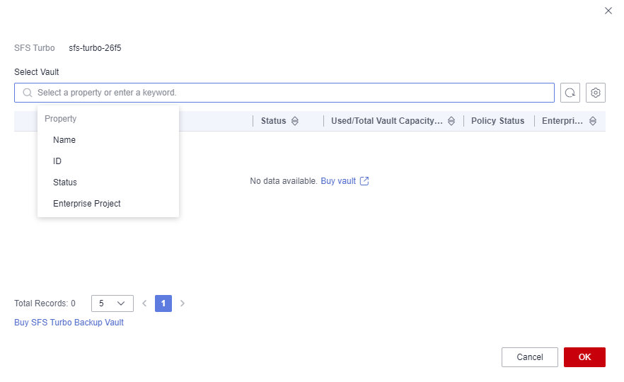

- Select a property (name, ID, status, or enterprise project) or enter a keyword to search for vaults.
Figure 2 Searching for vaults
- Select a desired vault and click OK. If the file system is already associated with a vault, skip over step 5 to step 7.
If you want to associate the file system with another vault, click Buy SFS Turbo Backup Vault to buy a new vault and associate the file system with it. For details about how to buy a backup vault, see Purchasing an SFS Turbo Backup Vault.
