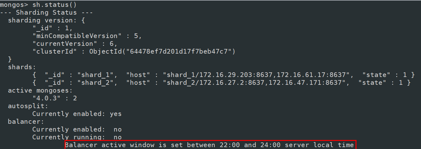

    You can run the sh.status() command to check a balancing window schedule. The following command output in Figure 1 shows that the balancing window is 22:00 to 24:00.
    Figure 1 Checking a balancing window schedule
