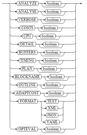

- Display the execution plan of an SQL statement, which supports multiple options and has no requirements for the order of options.
EXPLAIN [ ( option [, ...] ) ] statement;
The syntax of the option clause is as follows:
ANALYZE [ boolean ] | ANALYSE [ boolean ] | VERBOSE [ boolean ] | COSTS [ boolean ] | CPU [ boolean ] | DETAIL [ boolean ] | BUFFERS [ boolean ] | TIMING [ boolean ] | PLAN [ boolean ] | BLOCKNAME [ boolean ] | OUTLINE [ boolean ] | ADAPTCOST [ boolean ] | FORMAT { TEXT | XML | JSON | YAML } | OPTEVAL [ boolean ]
