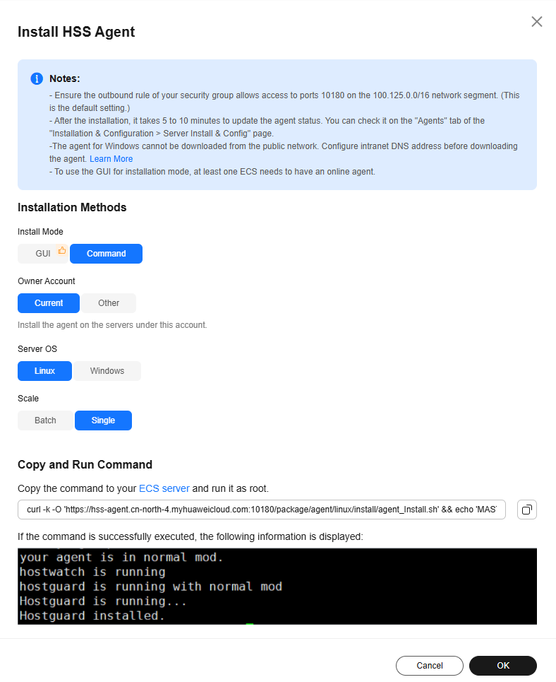

  7. Select an installation mode. For details, see Table 1.
    Figure 1 Installing an agent
    Table 1 Parameters for installing the agent
    Parameter
    Example Value
    Description
    Install Mode
    Command
    • GUI: You need to provide server account password or key for installing the agent. HSS does not save the password file you upload. To install the agent in this mode, ensure there is already an executor ECS - an ECS with an online agent in the same VPC as the target ECS.
    • CLI: You need to log in to the server and run commands or scripts. This method is used when you install the agent for the first time.
    Owner Account
    Current
    • Current: The server and the HSS quota you purchased are under the same account. You can log in to the account to obtain the installation commands or script and install the agent on the server.
    • Other: The server and the HSS quota you purchased are not under the same account. You can log in to account A to obtain the installation command or script, and install the agent on the target server under account B. After the agent is successfully installed, you can view the target server on the Asset Management > Servers & Quota page of account A.
    Server OS
    Linux
    Select the OS type of the server.
    Scale
    Single
    Select a value based on the number of servers where the agent is to be installed.
  8. Install the agent as prompted.

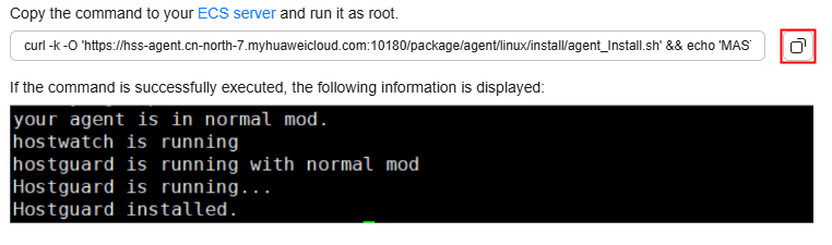

    1. On the console page, click in the Install HSS Agent dialog box to copy the installation command.
      Figure 2 Copying the installation command
    2. Log in to the server as the root user and paste the installation command.

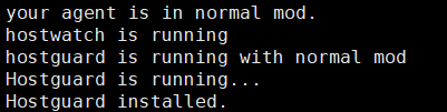

      If the command output shown in Figure 3 is displayed, the agent has been installed.
      Figure 3 Agent installed
