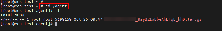

- Run the following command to access the directory where the agent installation package xxx.tar.gz is stored:
cd Directory_containing_agent_installation_package

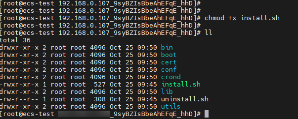

- Run the following command to check whether you have the permission for executing the install.sh script:
ll
- If you do, go to 7.
- If you do not, perform the following operations:

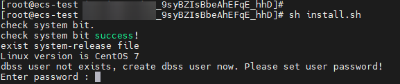

- Run the following command to install the agent:
sh install.sh
- In Ubantu, run the bash install.sh command to install the agent.
- The agent program is run by common DBSS users. When installing the agent for the first time, you need to create an agent user. After running the sh install.sh command, you need to set a password for the DBSS user.
