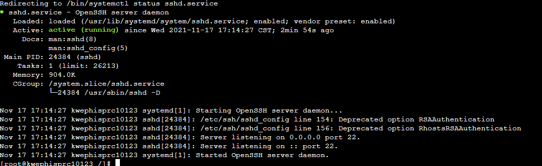

  3. Check whether sshd is started successfully. (The following figure shows that sshd is started successfully.)
