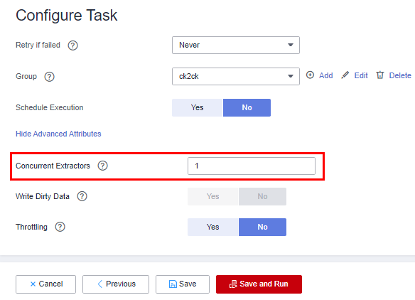

Figure 1 Setting Maximum Concurrent Extractors for a CDM cluster - Configure the number of concurrent extractors based on the following rules:
- When data is to be migrated to files, CDM does not support multiple concurrent tasks. In this case, set a single process to extract data.
- If each row of the table contains less than or equal to 1 MB data, data can be extracted concurrently. If each row contains more than 1 MB data, it is recommended that data be extracted in a single thread.
- Set Concurrent Extractors for a job based on Maximum Concurrent Extractors for the cluster. It is recommended that Concurrent Extractors is less than Maximum Concurrent Extractors.
Figure 2 Setting Concurrent Extractors for a job
