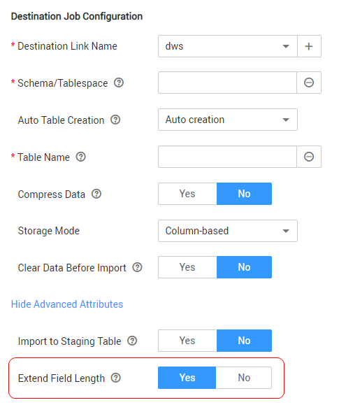

To solve this problem, you can select Extend Field Length to Yes, so that the length of the varchar field is automatically increased by three times when the destination table is created.
Edit the table/file migration job on CDM. In Destination Job Configuration, set Auto Table Creation to Auto creation, Extend Field Length is displayed in Show Advanced Attributes. Set Extend Field Length to Yes.
Figure 2 Extending field length
