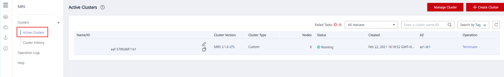

- Log in to the MRS console, view the existing clusters, and click a cluster name to access the cluster overview page. Figure 1 MRS cluster instance

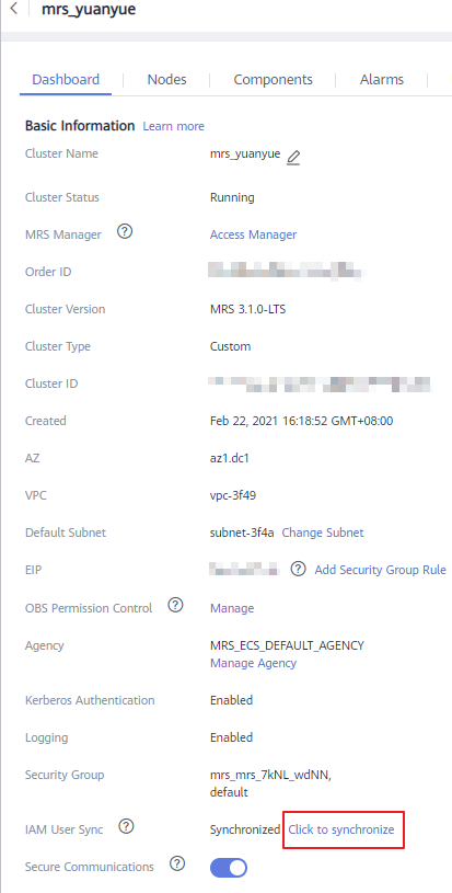

- In the IAM User Sync area, click Click to synchronize. Figure 2 Click to synchronize

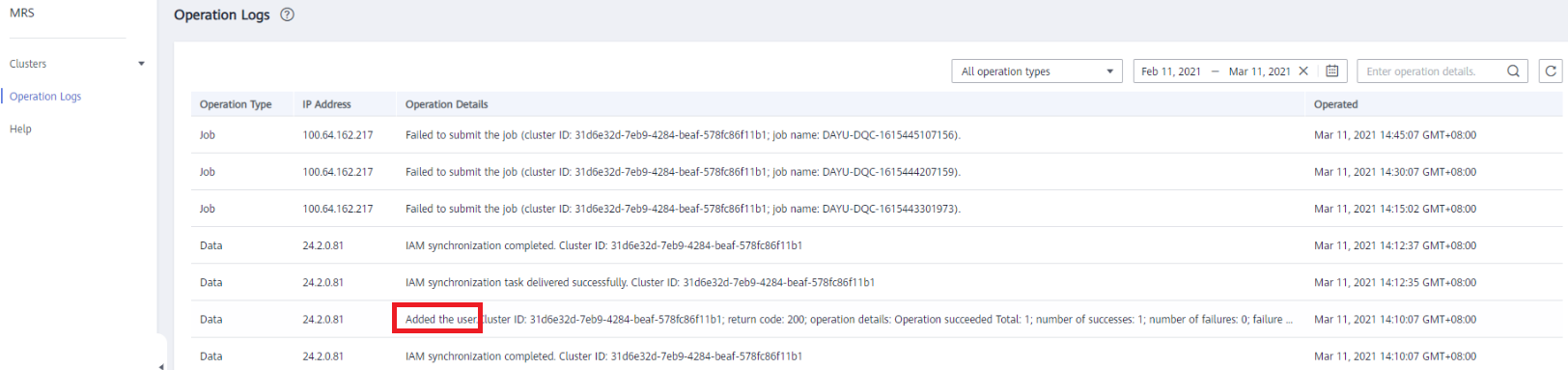

- View the operation result in the Operation Logs area. Figure 3 Operation log
