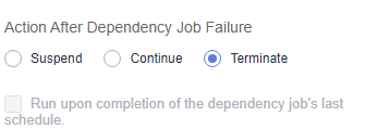

One of the jobs that depend on each other fails during scheduling.
Solution
The subsequent jobs may be suspended, continued, or canceled, depending on the configuration.
  In this case, do not stop the job. You can rerun the failed job instance or stop the abnormal instance and then run it again. After the instance failure is removed, the subsequent operations will continue. If you manually process the failure not in DataArts Factory but in other ways, you can force the job instance to succeed after the failure is removed and then subsequent jobs will continue to run properly.
