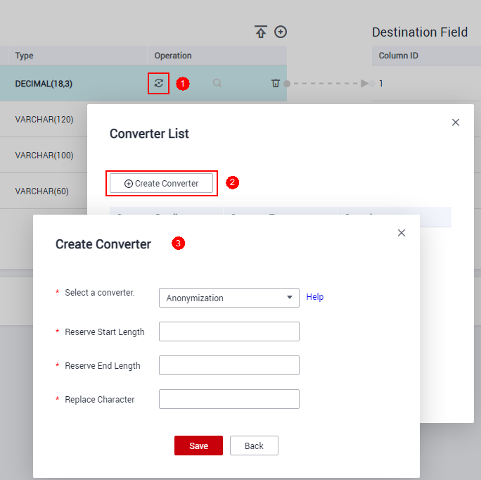

Anonymization
- Set Reserve Start Length to 3.
- Set Reserve End Length to 4.
- Set Replace Character to *.

- If the value is empty or null, "aaa" is returned. Otherwise, value is returned.
Expression: StringUtils.defaultIfEmpty(value,"aaa")
- If the field is of the string type, convert all character strings into lowercase letters, for example, convert aBC to abc.
