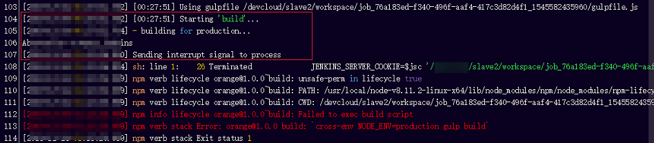

Build with npm fails, but no error log is displayed. The error is as follows:

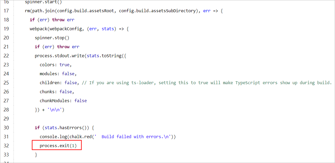

In the build script, it has been configured that the build stops when an error occurs.
Solution
Check the build script and delete the configurations that may cause the sudden stops when an error occurs, such as process.exit(1).
