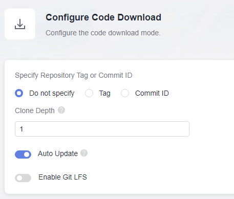

Symptoms
When CodeArts Build pulls code from Repo, GitHub, and other sources, the .gitmodules file exists and the configuration is correct, but the sub-module is not pulled.
Cause Analysis
Generally, this problem occurs because the automatic update function of the submodule is disabled.
Solution
Edit the build task file, select the Configure Code Download build action, and enable Auto Update for submodules.
